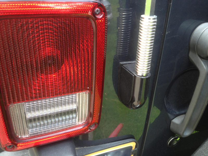

Well, that looks like a decent mount. A body mount like that should have a good shot at being grounded well. Do the screws that attach it to the body have a good metal to metal connection between mount and Jeep body?
Does it use washers? I wonder if using some star washers here would help to bite in and connect.

The ground is actually achieved by taking the coax shield from the lower terminal all the way back to the radio chassis and ultimately grounded through the negative power lead on the radio. You can go to FireStik's website and read all about it. Just click on the "Molded Side Mount" link on the left hand side.
The OP mounted his to the rear quarter-panel, but if you don't like the idea of drilling into your sheet metal, you can opt for securing it to the rear license plate bracket like I did (See images below). There are no holes in metal, no exposed wires or cables, and it is pretty inconspicuous when the antenna is removed.
FireStik Molded Side Mount Installed
FireStik Molded Side Mount Closeup.
For drilling purposes the rubber gasket makes a great template for locating the mount no matter where you install it. The mount is sold in a kit complete with Antenna, 18' cable, and the mount. I bought an LG3-M2-B, which has a black antenna that is 3 feet long. Different lengths and colors are available by changing the "3" to other available lengths and changing the "B" to the code for other available colors.

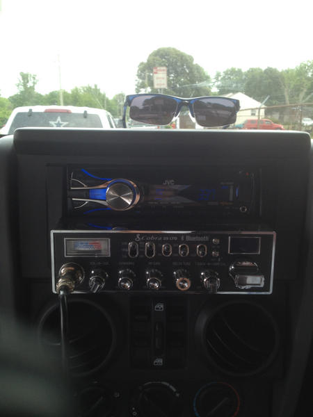

I have my radio mounted on top of the upper Dash Bezel. You can see my complete setup on my photo album dedicated to it (here). Like I said in my earlier post, I had this exact same problem with mine. Initially the negative wire to my CB was tied to the negative wire of the power outlet in the dash. The problem didn't start right away, but a few months after installing it, when I tapped the talk button o the microphone, the entire instrument console went berserk. I removed the radio negative wire and tied it directly to the chassis. Oh, there was one more change I made prior to relocation of the negative radio wire. It didn't help but I left them in figuring they couldn't hurt to be in there. That change was EMI suppression cores bought from Radio Shack. My system is golden now.
I just had another thought, although it's a long shot. To the OP, the molded side mount is made for NGP antennas only like the FireStik Firefly antenna. If the OP has a FireStik or a FireStik II antenna, there may be a compatibility issue between the antenna and the mount.
Here is what the FireStik web site has to say about the NGP antenna-based solution.
PURPOSE: The LGX-M2 (where X = antenna length in feet) series, 'No ground plane" (NGP) CB antenna kits were specifically designed to solve the problems associated with the lack of ground plane (counterpoise). This normally occurs on vehicles constructed of plastic, fiberglass, wood or aluminum. This includes, but is not limited to, motorhomes, boats, automobiles and 18-wheeler trucks. Ground plane problems typically show up in the form of high standing wave ratio (SWR) and poor performance. The isolated ground plane that is built into these kits can also eliminate problems on metal base vehicles that lack the sufficient ground plane for proper operation. This could be due to the size of available ground plane (ATV, bicycle, motorcycle, wheelchair, etc.), or because the operator chooses to mount the antenna in a location that is unable too properly take advantage of available ground plane. These kits utilize a stylish mount made specifically for mounting on the vertical side of a vehicle or structure. Aside from being a NGP kit, the main feature of these kits is that they utilize a lightweight antenna. The antennas are at least 40% lighter than the heavy-duty antenna used in the FGX-648 kits. This offers a more stylish look, while at the same time reducing mount stress that is caused by physical weight and wind load.

I just confirmed that only NGP compliant antennas can be used with the NGP mount. Copy, paste and adjust the address below for the write up from FireStik
h ttp://firestik.com/Tech_Docs/NGP_Install.htm
Oh, yeah. If the OP grounded the antenna mount, that's a no-no too.
