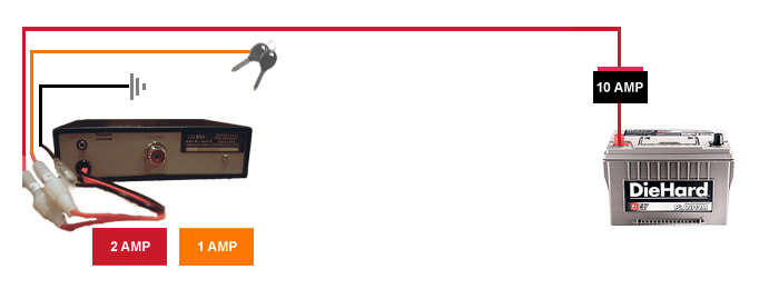

If you run your power wire to the battery, you place a larger in-line fuse (10amps is perfect) within 12" of the battery terminal connection. You radio should have a fuse in its back panel or on the power line(s), within a few inches from the back. Check you radio's documentation for the proper size (usually 1amp to 2amps.)
Use a minimum of 14ga wire, especially for any run over 8 feet. Over 12 feet, use 12ga. When in doubt, go larger.
Mine has constant (red) and switched (orange) power lines. Some CBs may only have a red line.
