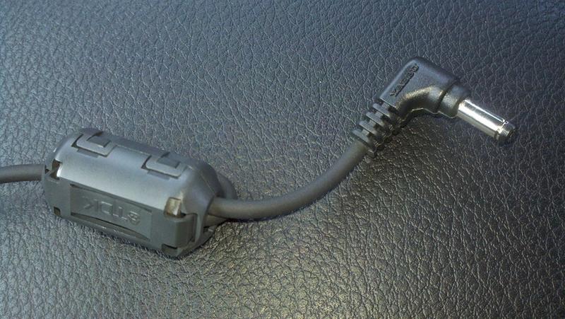

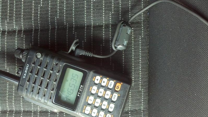

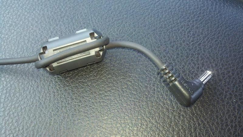

Today I powered up my 2 meter HT n the jeep. It has a cigarette power source. I noticed it has a RF/EMI filter on the power cord.
I've seen these around. maybe it will help you or anyone picking up noise from their Jeep.
Don't know if it will work, just a suggestion. The filter is there obviously for a reason
If you go to Mouser Electronics website and look up item # ZCAT1730-0730A-BK you see what it looks like on the inside and other technical specs.
I would get 2 of these filters and put one on the positive and one on the negative leads.
If anyone tries this (or has tried it) let me know.
