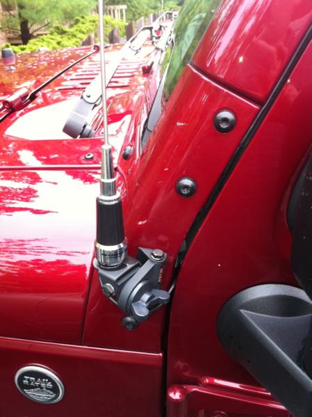

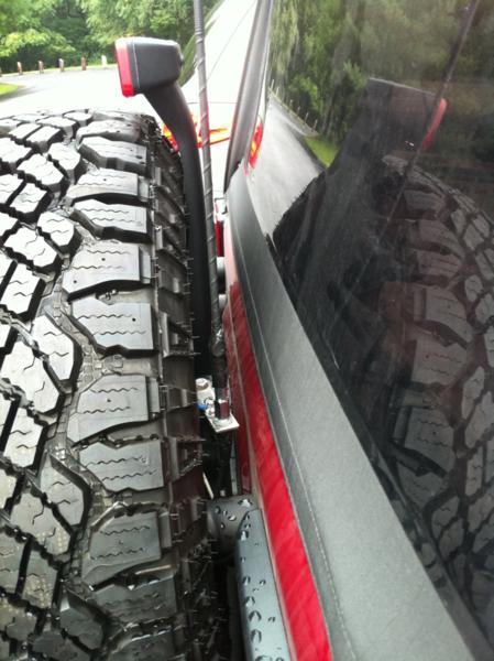

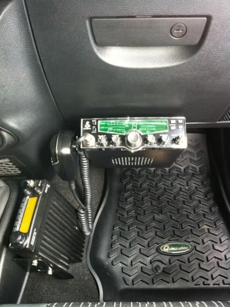

How about both? CB and 2 Meter, CB antenna at rear Ham antenna on side, had both antennas at rear and they kept interfering with each other so I moved Ham antenna and both radios work perfect now.
