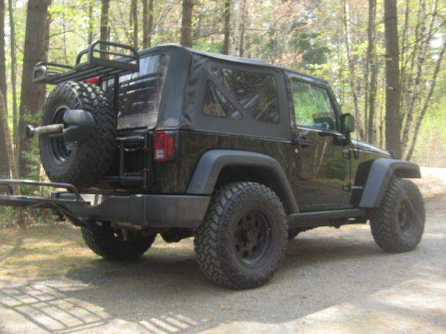

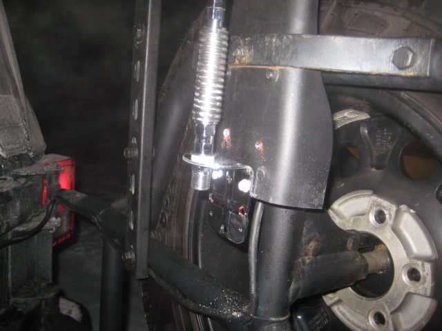

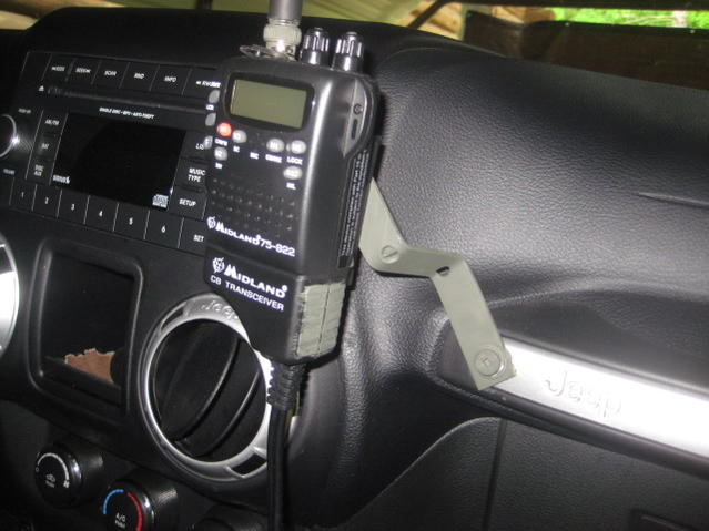

Default i have a 2 foot firestk
and i also have a 3 foot for if i need to get out further on a trip , but for most part 2 foot firestik is all i use mine works great for my needs . Mine even rests against a rack on mine still get great readings and swr
