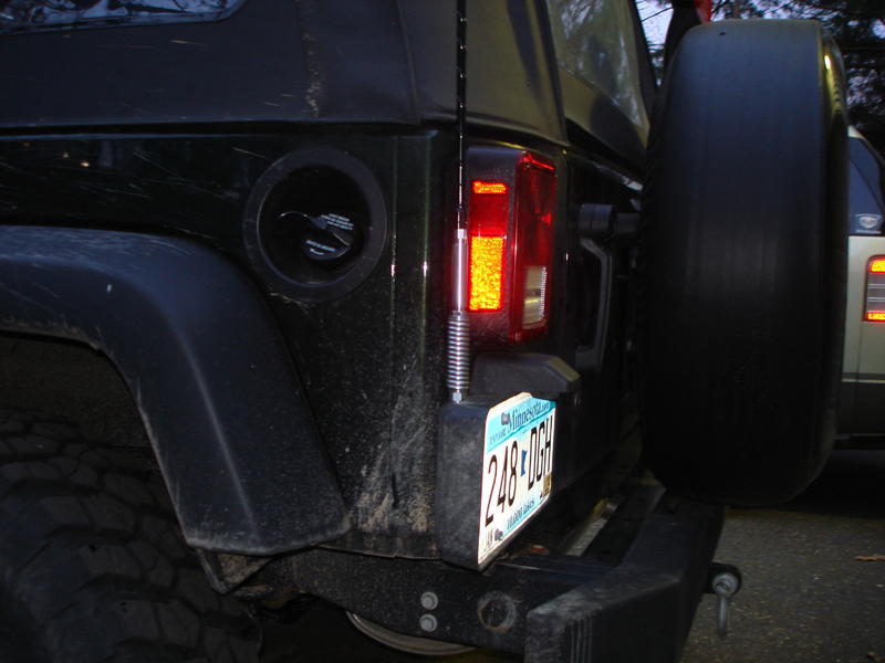

...had i been thinking i probably would of went with the lighter-duty spring instead of the HD spring, reason being that if your antennae snags something you want the spring to bend with the LEAST RESISTANCE and not the fiberglass antennae.
...it's still cool though and by screwing down the 'firefly' tip all the way down and capped i pulled a SWR of 1.1 on ch. 1, a 1.1 on ch.19 and a 1.2 on ch. 40.
...i sh!t you not.
...not much traffic on the air-waves though...alot of latino's for some reason though i guess there is a couple of tree nurseries nearby.
...the weather channel comes in very well also.
