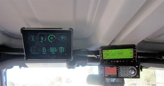

Wow, great setup. That SWL receiver looks really "sweet". And the custom rear bench is first class. That will surely inspire the little one. I have fond memories of my first SWL rig, seems like yesterday but, cough, it was some number of decades ago.
I have that same speaker for my FTM350 - sounds great.

Cheers Shawn! That's an interesting place to mount the iPad. How have you mounted it?

It's a Nexus 7 that snaps into a mount. The mount is affixed to an ARR bar using RAM products. It's nice because it doesn't obstruct the forward view at all yet it is in plain view. The RAM devices allow it to easily fold up flat when not in use. I don't keep the Nexus in there too often, so usually the mount is just folded up and empty.
Ahh. I thought it was a RAM Mount. I use several in mine, too. Love them!
