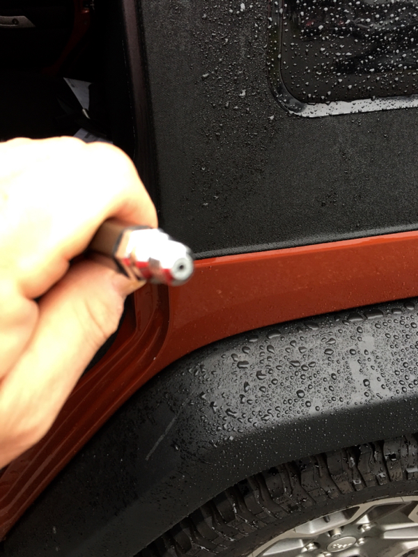

This is what I have.
Old Dec 22, 2015 | 10:13 AM
Mark Doiron's Avatar
Posts: 14,800
Likes: 374
From: Midwest City, OK
The left picture is your PL-259 connector. The right picture is your antenna. You place a CB antenna stud mount on whatever mounting plate you plan to use. Typically through a half inch hole. On the bottom of the CB antenna stud mount is an SO-239 connector. The PL-259 will mate up to it. On top of the CB antenna stud mount is a threaded hole. Your antenna screws into that.
