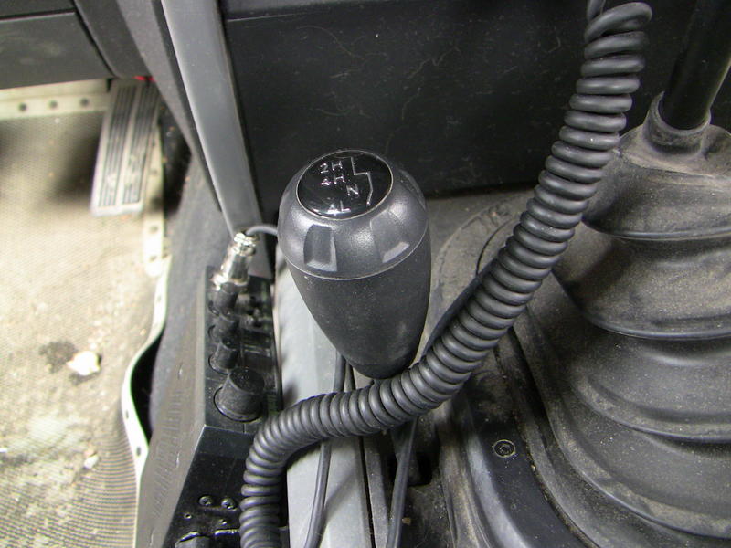

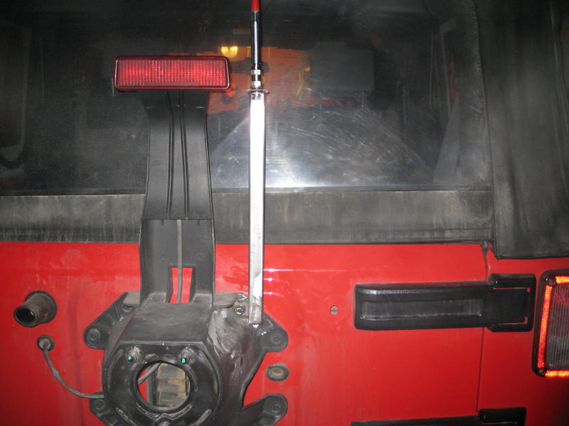

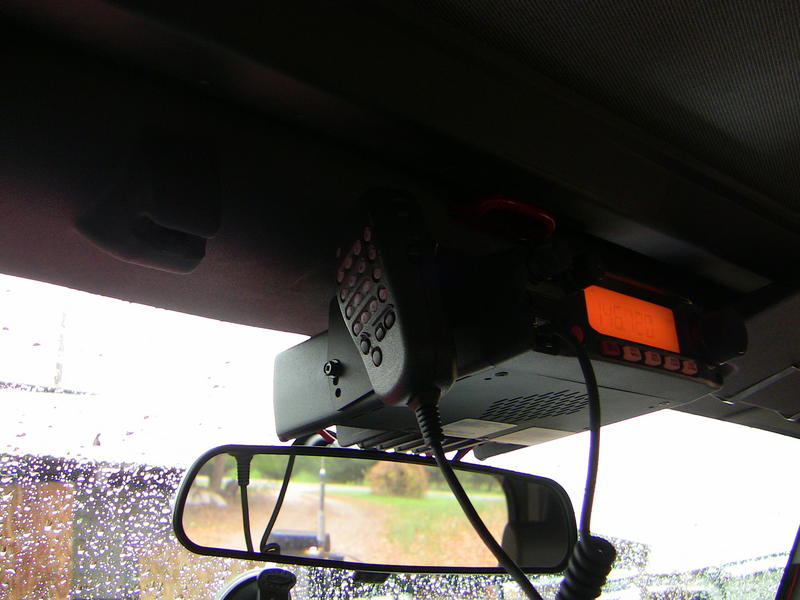

1st is a picture of the Uniden on the tunnel. 2nd is where I mounted my Radio above the mirror, the picture is of my yaesu ft2900, but I did have my CB a full sized uniden grant there before I got my ham license. The other picture is the antenna mount on the tailgate.
