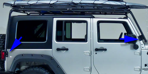

I have a Wild Board cargo rack installed in my '11 JK and I was wondering where you all thought the best place for an antenna might be? I don't park in a garage so that is not a huge concern.
Here is an example of the roof rack and where it mounts to the Jeep, this is from Wild Boards website.

I would recomend a cowl mount or mount on top of the rack.
