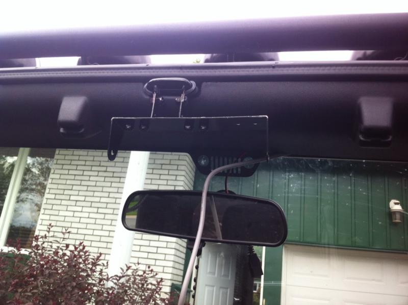

This is how my cb is mounted
ID:	326275   Click image for larger version

Looks nice. I'm a little jealous of that nice radio! You could easily ground the case and see if it makes any change. Simply take a short piece of wire from the thumbscrew to a bare metal spot on the jeep. The shorter the wire the better. FWIW, I didn't see any requirement of the such in the owners manual, but you can try it. It is free to try and an easy remedy if it eliminates the problem.
