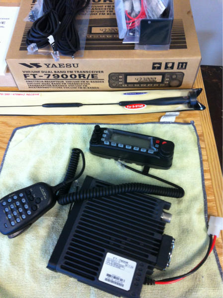

After a few days of looking around I think the Yaesu FT-7900R might be the one for me. I like that it has back-light buttons and has a detachable face. If I mount it below a seat will I then have to have an external speaker to hear the RX audio?
It's standard practice to use external speakers when hiding the main body of the unit.
Note that installing the main body in an out-of-sight place can restrict necessary airflow over the unit, increasing the temperature out of tolerance.
