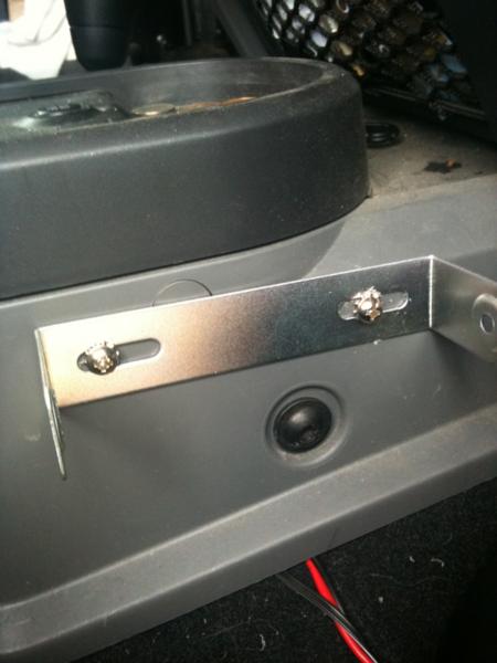

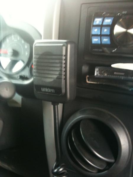

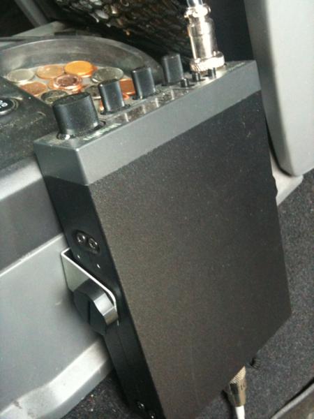

Or switch to a Uniden Pro 510 or 520(can use a PA speaker with 520). Cheaper then a Cobra and durable..... Mount it beside stick shift console... I did mine on passenger side doesn't get in the way comes with bracket screws etc.
