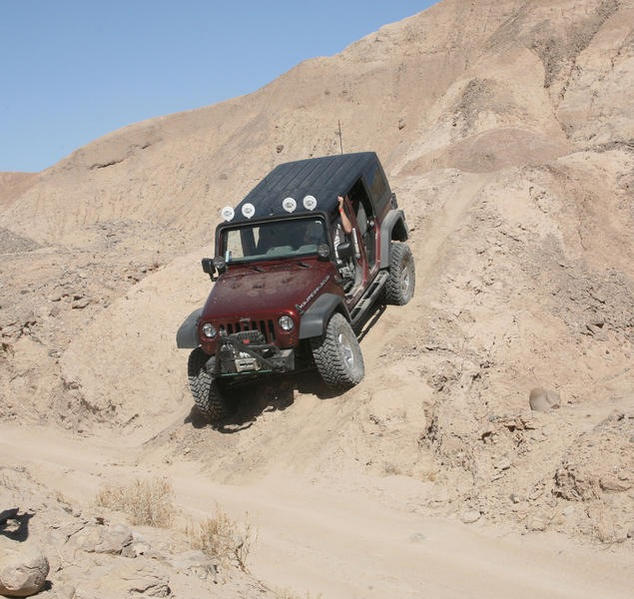

My 2m/440 is in the center position of a five light over-windshield bar from Rugged Ridge. Fantastic place for it and the coax fit nicely in the provided grommets. I have my CB on a home-made spare tire mount bracket. I'm actually planning to move the CB to the drivers mirror relocation bracket, just haven't had the time. This will give me FM on the passenger side, HAM top center and 11M drivers side. Currently the HAM on top is fixed, but popping off one of my freedom panels lets me reach up and unscrew it. I am considering the Diamond K9000 motorized antenna lift that would let me flip a switch to lower the HAM antenna, but it's a hundred bucks and I don't go into garages if I can help it, the only time I had to reach up and remove the antenna was wheeling in the woods to get under some low branches.
