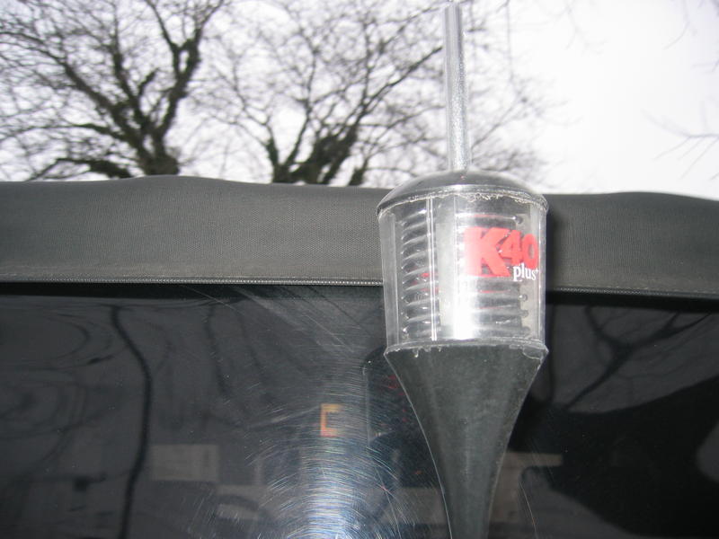

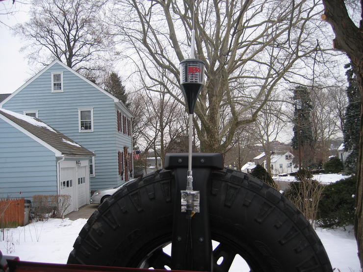

Old Jan 17, 2011 | 12:20 PM
09DARKORANGEJK's Avatar
Joined: Apr 2010
Posts: 226
From: Easton, Pa
where i have it mounted

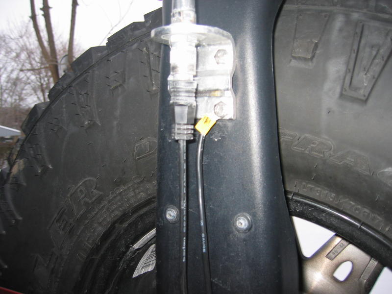

10 gauge wire for the ground on the bottom right bolt

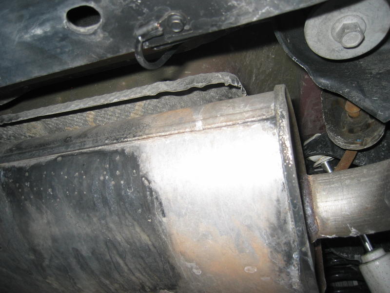

this is where i grounded to the frame. I sanded the frame to bare metal attached the bolt and wire then sprayed flat black over it to prevent rusting

If you remove that ground wire does the SWR change at all? If not, I'd start looking at at the coax cable, it might be bad somewhere. Disconnect the coax from the radio, then test it to make sure there is no continuity between the center pin of the coax and the outside of the coax connector outer shell. If that's not it, then I'd suspect the SWR meter in the radio. Does the red antenna warning light come on when you transmit?

Did you put the other meter on? Wonder if that K40 is loading up properly....when you move the tuning whip do you see a difference? The coax should be suspect too like the other guys are saying...or have you already checked it/swapped it with a known good piece?

Also high SWR's can be causd by looping the extra wire. It creates all kinds of weird stuff when you do that, sure it looks nice but it wreaks havoc on the SWR's. As far as the light, are you sure that just isnt an indicator that you are using the mic?
