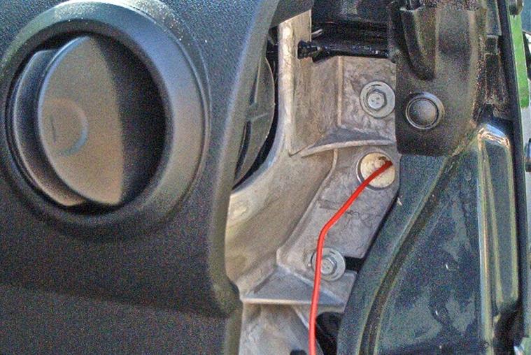

I haven't climbed under the dash to look yet but is there already a hole to thread the CB wires through to the battery or am I going to have to drill?
Take off the passenger side panel and you can see a small circle with yellow foam in it. Just take a coat hanger to the foam and punch a hole through it
Cool! Is there a trick to getting that side panel off? Is it screwed on or does it just pop off?
Just pops right off. i found its best to remove the AC vent, then pop it out thro the AC vent hole
