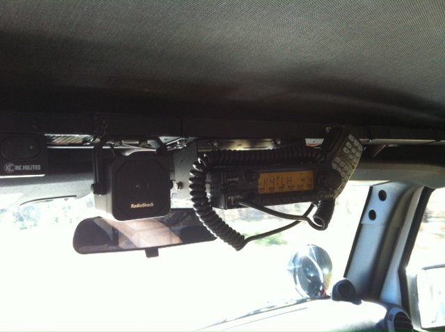

i wanted to throw this picture in to show the radio mount bar offered by Arizona Rocky Road (ebay).... My 2m FM radio is shown (IC2200H) along with an external speaker (for the HF rig)....I also mount my rocker/light switches on it. I use cable ties to hold cables and wires behind the bar out of sight.
I wrap the mic cord around the radio so it doesn't dangle.....

Nice setup, Drykard. I still do not understand where the radio mount bar attaches to the Jeep and whether it gets in the way of removing/installing the freedom tops when one gets ready to do so. As you can tell -- there's lots I do not understand about installing stuff in Jeeps. But you folks sure do make it easier -- and a lot more fun. Now if I can shake the last of this flu and get some warmer weather -- I'll be ready to play with that big bad toy.

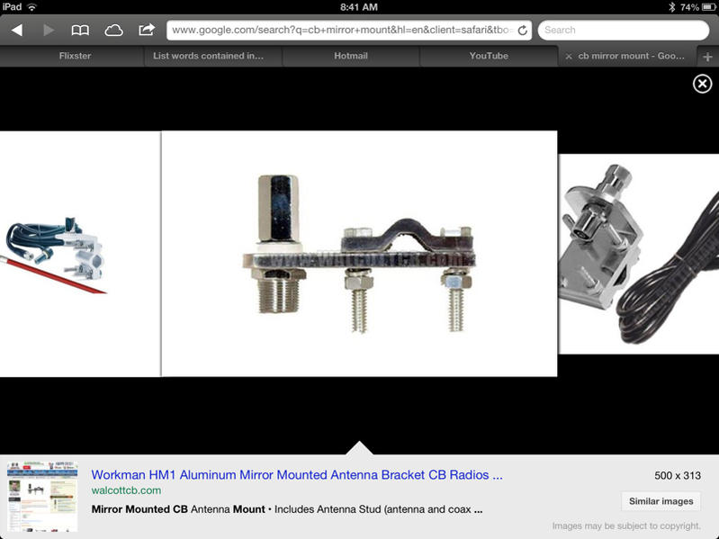

I got it at a cb shop in Downey. The mount was a standard trucker mirror mount with 2 pieces that bolt together the mount was like 6 bucks. here is a pic.
i cut the length down and drilled a couple extra holes to put some self tapping screws through.
