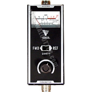

I'm on my second SWR meter. First, I had an Astatic meter, then when I thought perhaps it was faulty, I contacted Walcott CB on line and they recommended the Vanco SWR meter (pictured here).
My readings are always in the red between 6-10. I litteraly peg the meter
I've performed all the tests, swapped out antenna's, coax, mounts and radios. This is killing me because it's really a simple thing, but for what ever reason, the answer alludes me. All I can hope for is that the new radio I ordered changes everything. Worst case, nothing changes and Im back to square one. I live in Maine and am so anoyed by this I'm about ready to drive to Arizona to have Firestik tune it!!!! (I wish, boy the warm sun would feel good right about now).
