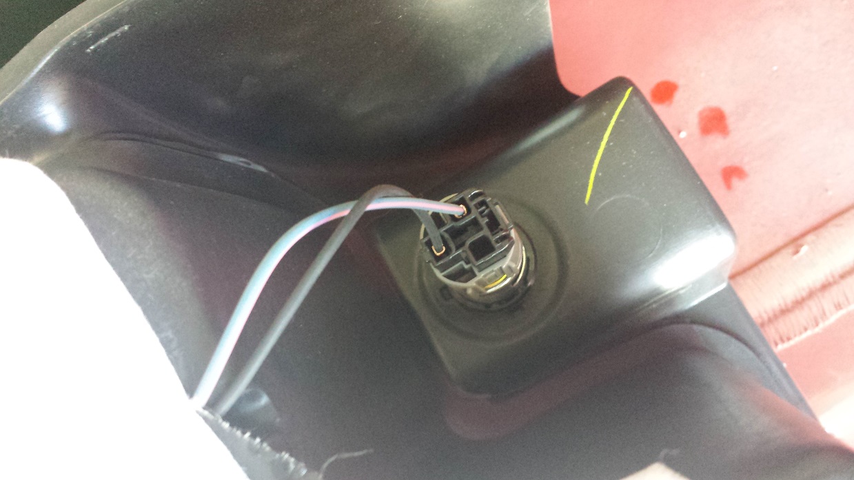

You didn't say what year your rig is? Mine's a 2011, and here is what the back of the 12VDC outlet looks like behind the speaker box.
