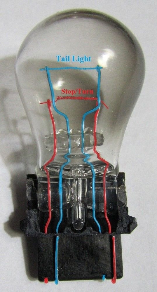

Here is a picture of the tail light bulb, showing the two filaments. See if your bulb's stop/turn filament is broken.
The stop/turn circuit has no fuse. The running light circuit does have a fuse.

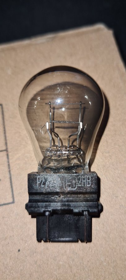

Hello everyone,
Thank you for all the help! The problem is solved! The result was a dodgy bulb. Visually the filaments were not broken, however the bottom one was shorter on one side, so I think that may have contributed. I thought what the heck, I might as well pay another £2.50 for a new bulb and if its not another bulb issue then no hard loss. With the new bulb, everything works perfectly!
Here is an image of the culprit.
