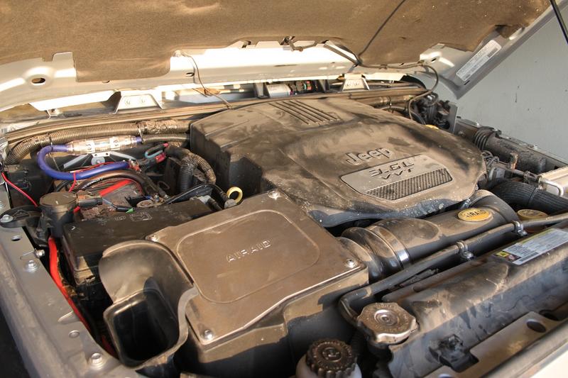

Well I did end up finding where it came back out and connects to the chassis. I ran it my own way but got there to the same spot though it is a little snug in the area. Not sure how much of a difference it will make but makes me feel better knowing it should have higher capability now. I didn't bother to remove the factory ground cable, just added mine in as well. The problem I'm seeing is that the ring terminals that came with the cable are significantly larger than the bolts they are mounting to :(
Old May 18, 2012 | 02:33 PM
stormtrooper75's Avatar
Posts: 45
From: virginia
post a pic of your engine bay.
Old May 29, 2012 | 12:40 PM
Infinutty's Avatar
Posts: 227
From: Dallas, TX
Not sure if I can get them added properly but I've got 4 pictures in my album showing where I ended up grounding the battery as well as few shots of the bettery side of the 2012 engine bay
