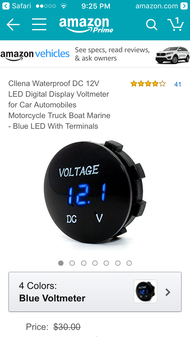

That have ones for cig adapter that also includes a USB output so you don't lose that functionality. Here is a Stand alone panel mount that looks interesting on Amazon. It is very low profile.

I was actually looking at that one. Tempted to run it direct to battery.

Id consider running it to the same wire as the cig adapter in the dash. That way it won't be on and drawing power when the ignition is off.

Didnt think about that. That's a great suggestion.

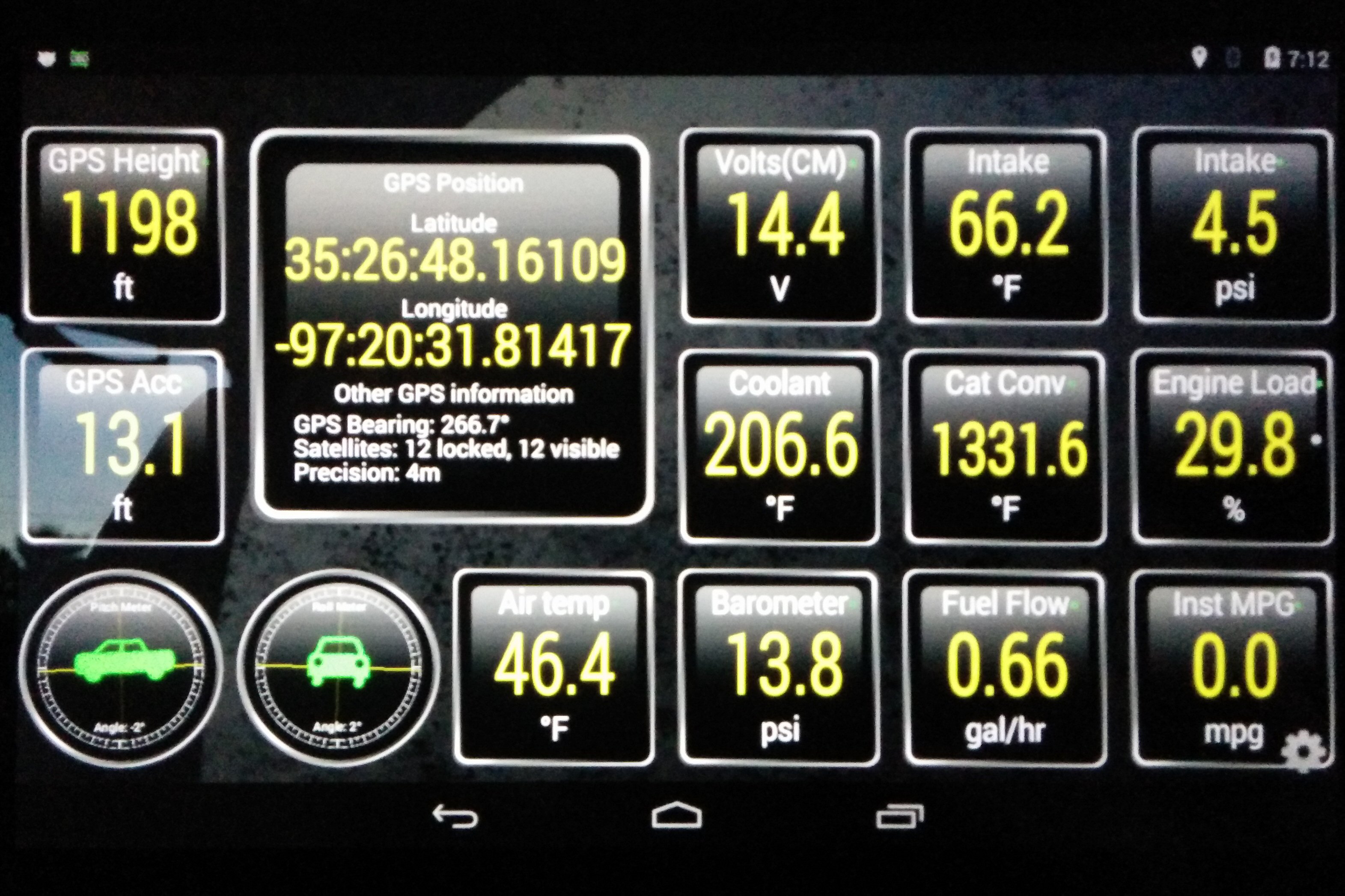

Since I have two batteries I like to monitor both. Two different solutions.
First, I've set up the Android app Torque Pro to monitor the starter battery voltage. I can choose where to monitor it, and have chosen at the TIPM (CM means command module--I've since modifed that title on Torque Pro).

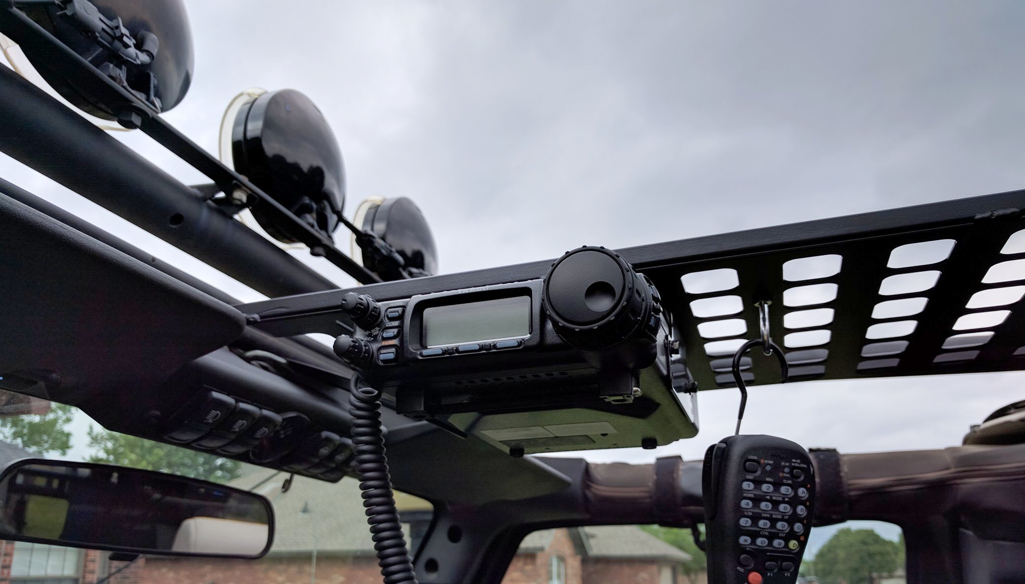

The second came about when I installed a ham radio. The radio monitors input voltage, and it's tied directly to the aux battery ...

Normally both batteries read the same since the isolator ties both to the alternator, and that's what's really being read (alternator voltage). However, there are a few times here and there when the isolator separates the batteries, and this arrangement lets me know that is happening, and the status of each battery. Of course, normally before engine crank I can read the actual battery voltage on both of these (though I must have the ignition on for Torque Pro to pick up the CAN bus info).

And it's done! I tapped into the cigarette lighter couple inches over and it's working!
