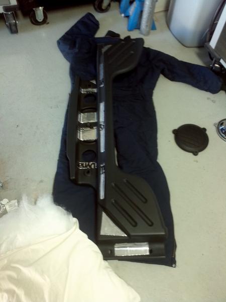

Soundbar:
I took it out of Jeep very easily. 6 10mm bolts I think and the connector on the passenger side. Was lighter than I thought and I just let it rest on headrests and it was no biggie to do by myself.
Dynamatted some strips on the outside where no one could see, put a little foam gasket around the dome light, and dynmatted and polyfilled inside the ends. I actually took some dynamat and made dams inside the soundbar, closing off the end pods.

Soundbar:

Soundbar feels more solid and I dont have any rattles..yet. The factory amp seems to roll off the lows around 150hertz or so, so no major bass from these guys and volume is limited. Volume doesnt bother me much since it's just for fill anyway, and the highs picked up nicely. It's trebly and low volume, but much more crisp and clean to me.
