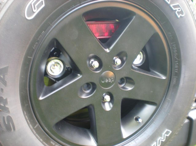

A lot of people take the stock 3rd brake light and just cut most of the bottom off to where it can sit on the tire mount an shine through the spare wheel

Yeh, some use the factory light, others use a red led strip but the concept is the same. Just cut the stock light tower, attach some L brackets or whatever and mount the light to it, the height would vary depending g on the opening of your wheel. Another example...
