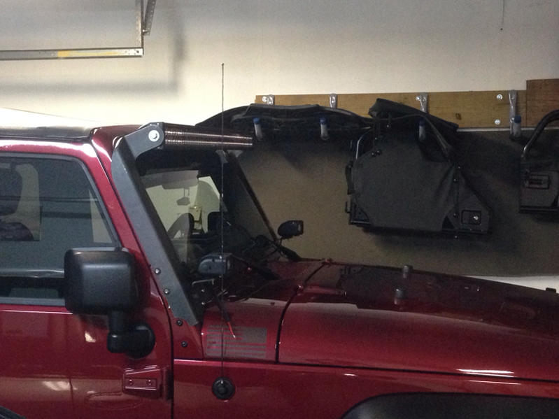

I'm running HMF 50" brackets with tabs and eBay 50" bar
I love the set up... But the wind buffering is stupid loud with a soft top
I can live with the noise, since it's a weekend toy and summer vehicle (no top). But I don't think I'll be able to handle the wind noise when we take it to Moab in Aug.
Driving 600+miles a day... I'm might lose my mind... Lol
I have experimented this evening, turning the bar 45* and facing it down. Now that is my solution for ALL DAY HWY DRIVING. Seems like it helps, and since I'm not going to having it on during the day... It won't hurt.
