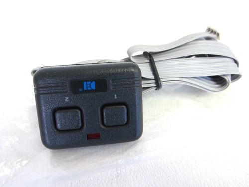

If I could just somehow wire in an actuator to manually push the button on the in-car pager panel Click image for larger version
ID:	546521when the factory alarm's horn goes off , jury-rigged as hell but it would serve it's purpose of notifying me when the factory alarm goes off.

Originally Posted by 2010jkSahara
sounds expensive. I got the pager module for free and used so I do not exactly want to spend a lot of money on something that was state of the art 15 years ago.
If I could just somehow wire in an actuator to manually push the button on the in-car pager panel Attachment 546521when the factory alarm's horn goes off , jury-rigged as hell but it would serve it's purpose of notifying me when the factory alarm goes off.
Well, I did it. I tapped into the wires of one of the buttons and wired it into the horn's wiring via a relay. Now when the horn goes off from the factory alarm the relay connects the two wires and that sends a signal to the pager.
