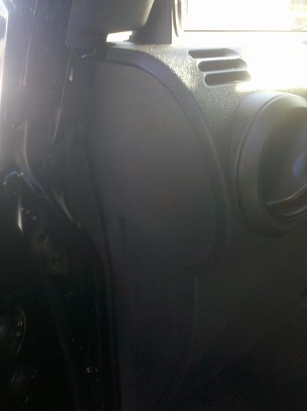

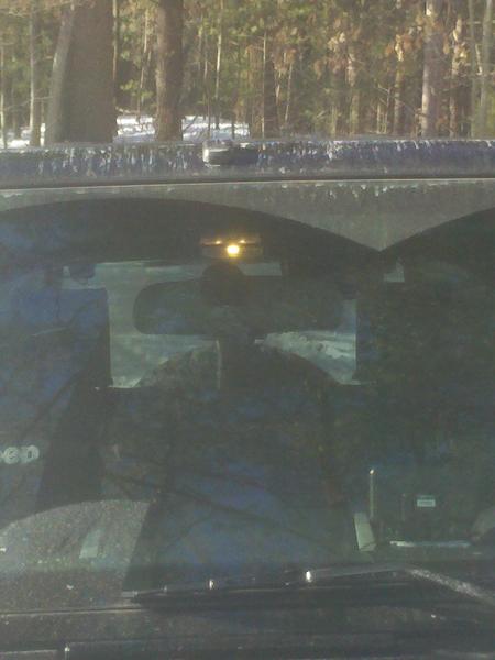

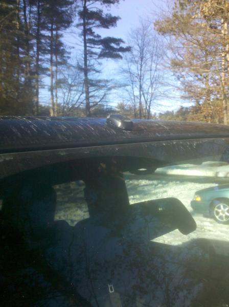

Ok here are some pics. You can see where I mounted the antenna on the top above the windshield. I tucked the wires along the windshield rubber lining then opened the dash panel up in pic 3 to tuck the excess wire into (pops off easily). Then I tucked the wiring on the inside under the windshield between the dash and mounted where shown. I didn't use the included Sirius radio mounting bracket as it kept coming unstuck from the dash. I just bought some velcro mounting tape and it worked like a charm and has less of a footprint as well. Let me know how it works out.
