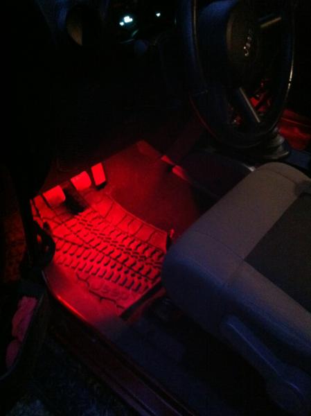

You do need to hook up to both speakers. But the adapter goes in just behind stereo so everything is accessible right there. Also I ran power from battery AND a remote line to a power source that comes on with the key.
Everything I needed came with the kit included instructions. Oh the adapter was separate.

Oh and added a bit of lighting while the dash was pulled out. "thumbs up"!

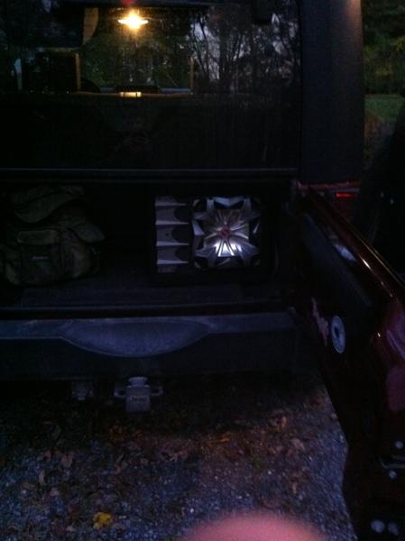

I did the same thing. Picked up a line output converter and went with the stock unit. Put the amp under the driver seat and 12" audiobahns. In the trunk.
