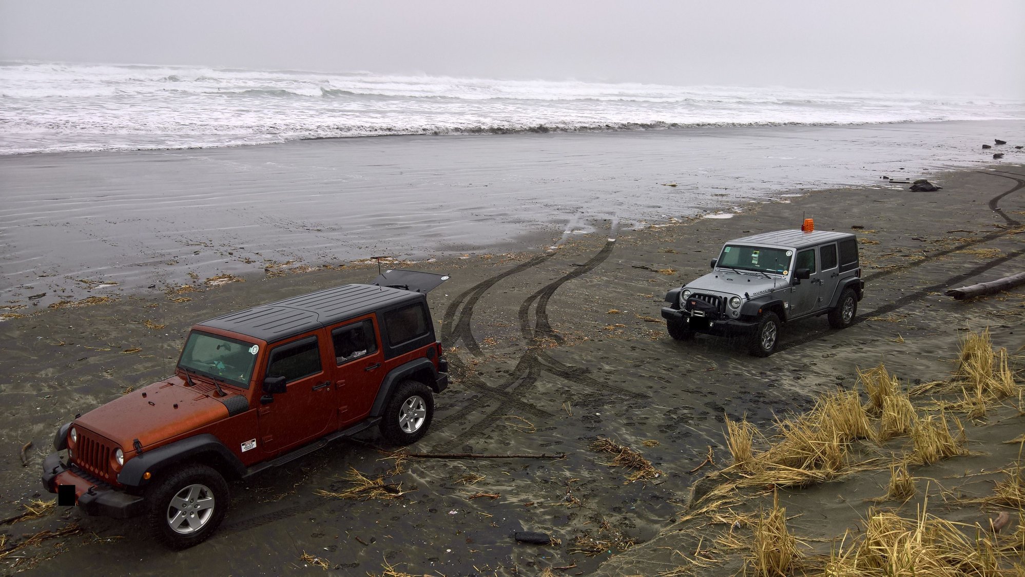

After having gone for... a fairly serious swim (painful detail in another thread), friend's 2014 JK has what I've now discovered is a weird issue with headlights.
It seemed that the driver side headlight was out. When lights switched to on, it's out, everything else (passenger side headlight, fog lights, markers) just fine. Of course I immediately suspected blown bulb or connectivity/harness issue.
Until I discovered that if switched to parking lights only, ALL the lights come on - including BOTH headlights.
And when lights switched to off, again ALL lights are on (like DRL option?).
So this is telling me the issue must be in some controller somewhere. Anyone experienced anything similar?
