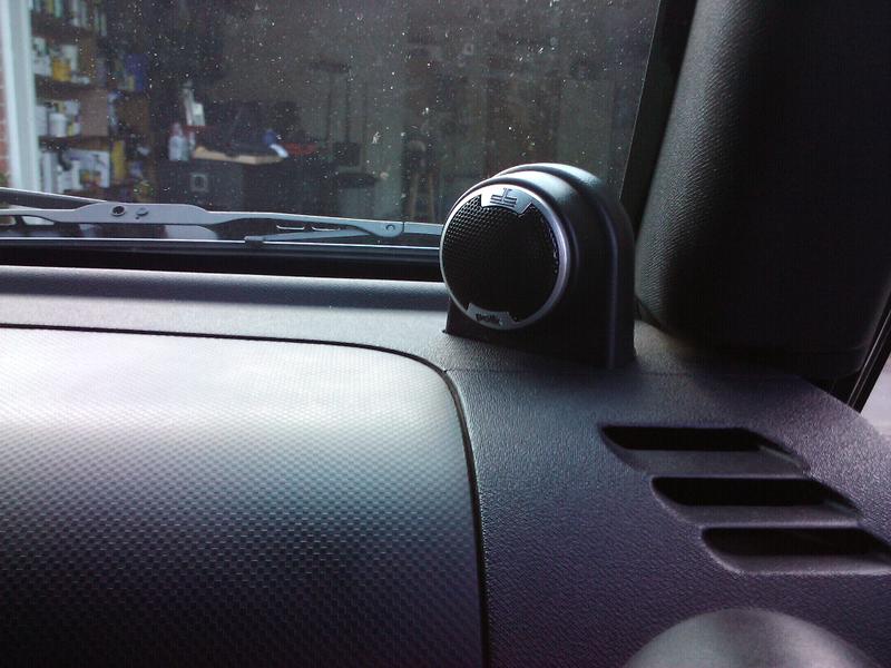

For those of you with the Polk DB's any advice on fitting the tweeters into the stock housings?
Old Jun 19, 2011 | 05:08 PM
enzo319's Avatar
Joined: Mar 2010
Posts: 206
From: OKC
2 options.
1 cut out the stock hole with a dremel 2 make the db's fit with the included cup.
2 use the other included cup and put 3 daps of superglue on the back of it and hold it in place until it dries
