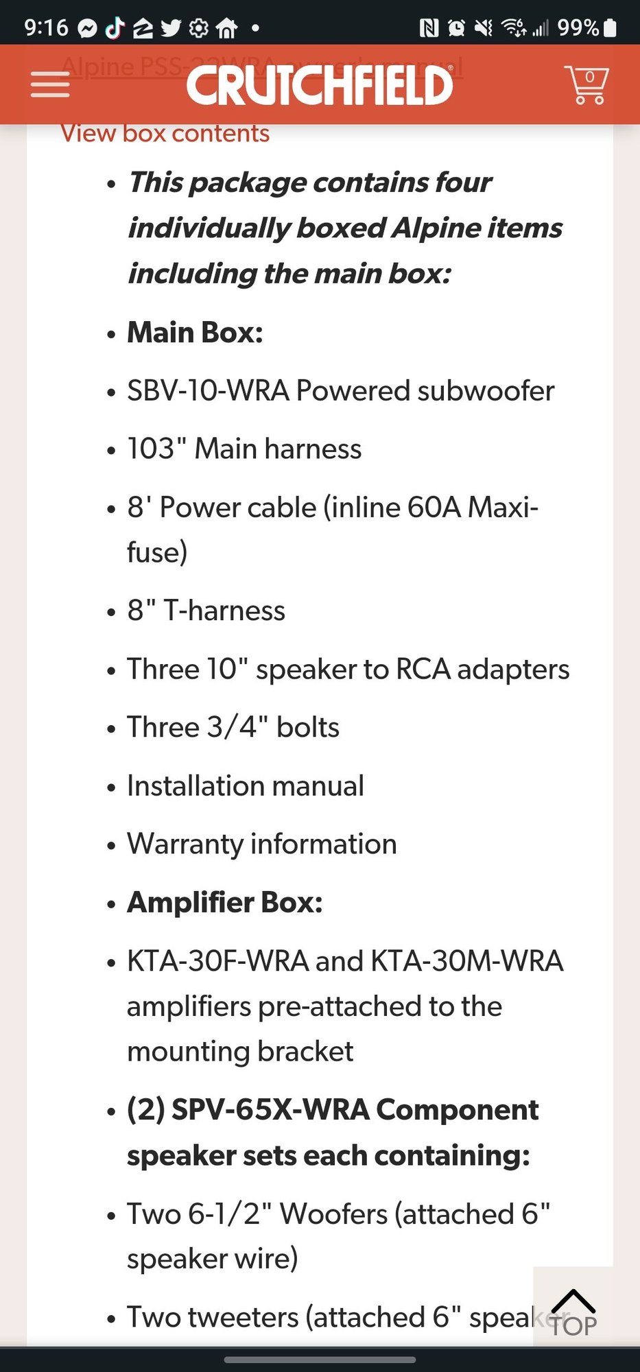

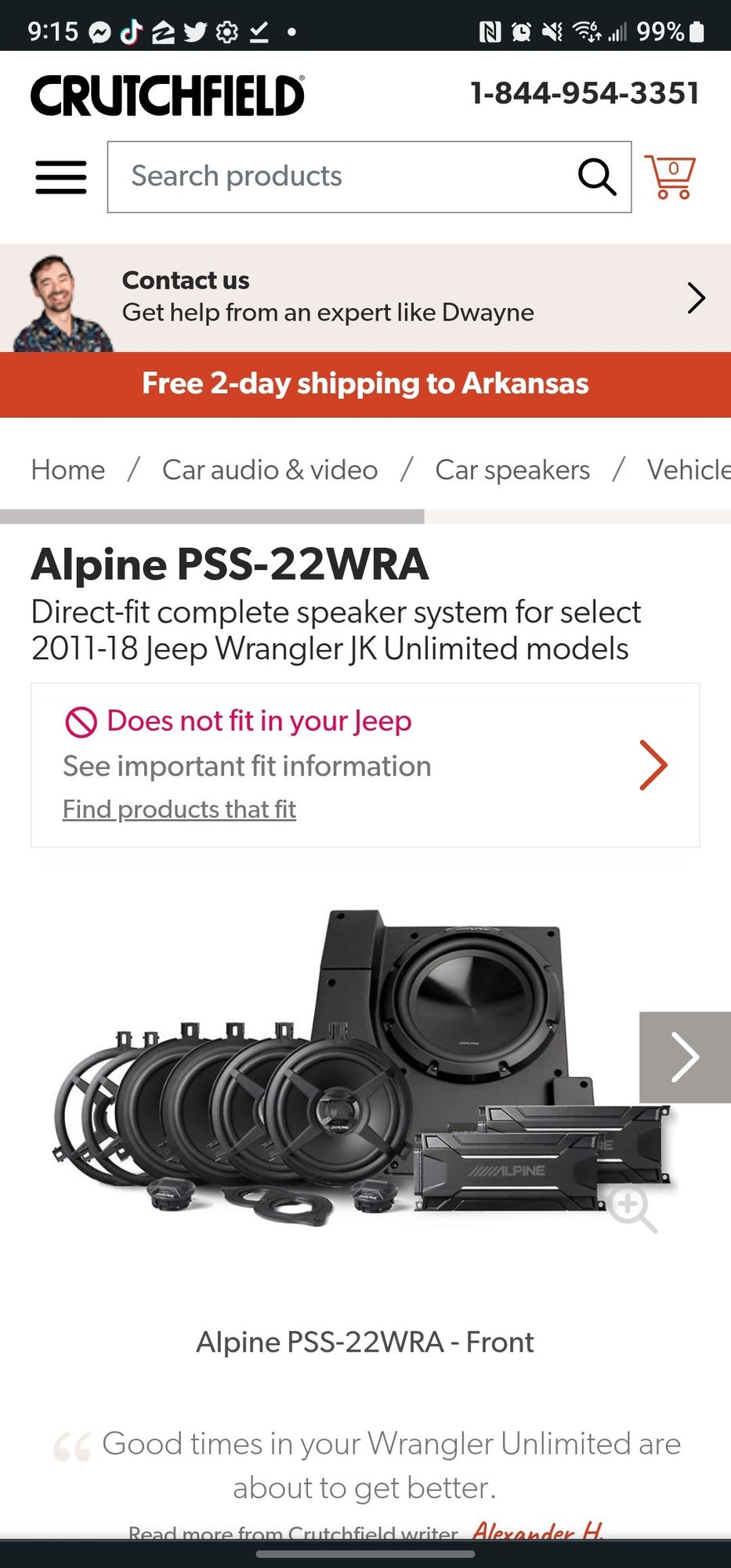

Ok yall I plan to EVENTUALLY do a write-up if all my research & planning turns out to be correct. I've only found 1 thread on here regarding basically just an inquiry about buying the PSS-22WRA so if anyone wants to weigh in, feel free to do so. For those unfamiliar with what exactly the PSS-22WRA is/contains, I have attached some screenshots from Crutchfield.
"The Claim":
Alpine "claims" that the PSS-22WRA is only compatible with 2011-2018 JKU Automatics.
The Investigation:

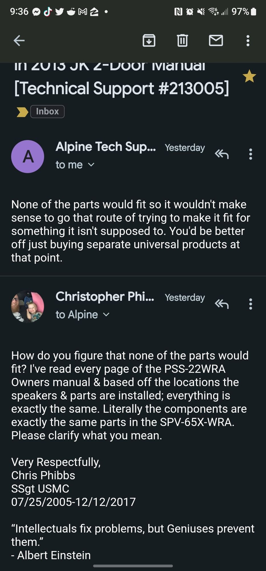

However after reading every single review on Crutchfield, I did come across a few JKU Manual installers but they each said the designated Amp location caused them issues due to the clutch pedal assembly. So I decided to go to Alpine with my questions because after reviewing the contents, I looked up each piece individually (on Crutchfield & Alpine) only to find that they all do in fact FIT 2-Door JKs no matter the Transmission. So I read the entire owner's manual 1st before sending a message to Alpine Support asking them to clarify what exactly restricts the PSS-22WRA from being installed in my 2013 JK 2-Door Manual. I have also attached the response I got from them plus my reply & let's just say I felt like I was brushed aside lol.
