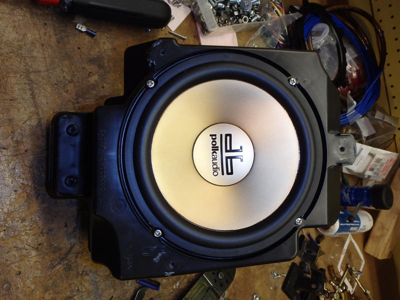

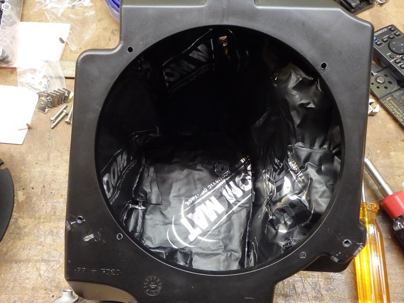

I covered the inside of the front speaker boxes with Boom mat. One 12x12 inch piece was enough for each box. Then filled with polyfill. I found that removing the bracing bar on the knee panel allows the pesky drivers side box to be wiggled an removed a little easier (it was only 2 bolts.

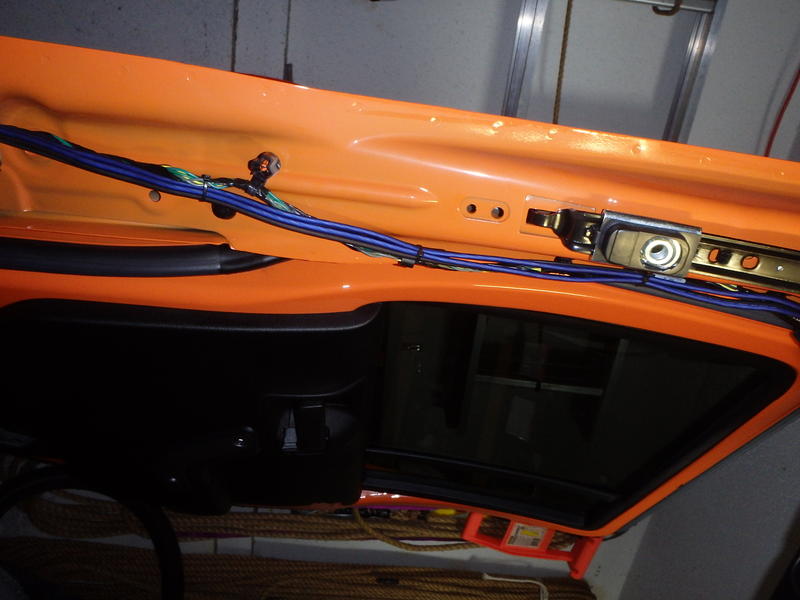

Same thing was done with the speaker bar, but only one piece of boom mat laid in behind the speaker (2 more 12x12inch pieces). New speaker wire was run down the B pillar.

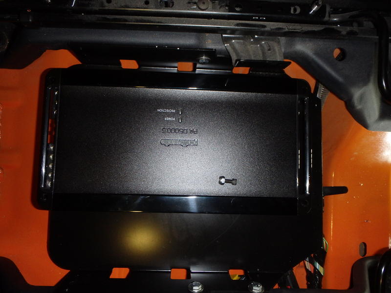

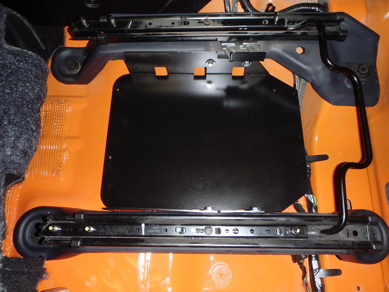

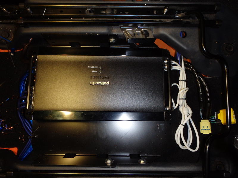

I mounted the amp to an underseat bracket I got from ebay (after I gave it a quick coat of paint).

Amp mounted on seat bracket

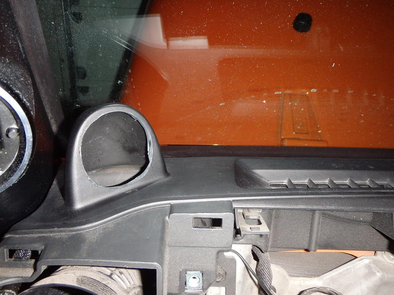

I enlarged the hole in the tomb stone tweeter mounts to fit the press in cups from Polk. This was time consuming even with a paper template to follow. Lots of test fitting.

Here's the amp all wired up

This took about 16 hours to do. I tried to stay neat about everything using zip ties and hiding all the wires. I have not tuned the amps yet (need to borrow an oscilloscope), but it sounds great. I've never used Polk before (mostly Pioneer), but I like them. There's a reasonable amount of bass considering it's just a 6.5 inch.

Yes. I got a 4 AWG power wire 20ft. Ran it from the battery through an existing hole on the passenger side just behind the side dash panel. It goes down the rest of the A pillar, along the edge of the floor to the B pillar where it goes to the amp under the carpet. I can get some pictures of this for you. There's a ground point on the tunnel under the seat bracket. I used that for a ground. It's tricky to get to without pulling the seat bracket up, but with an angled ratcheting box wrench it's possible.
