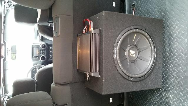

I ran mine through a hole on the passenger side. Above the glove box behind that side panel. There's a hole with spray foam sealing it. I just used a coat hangar to poke a hole and tape it on, then pulled it through. The battery is right there.
Make sure you dont run your power/remote turn on wire on the same side as the RCA. Run the RCA cables on opposite side of wherever you have your power wires.
in my case, power and remote wire is passenger side. RCA is on drivers side. And I oriented my amp so they match up so nothing is crossing.
