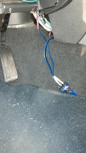

Well I finally did it. Took a whole 5 minutes to do. I just have to mount it and drill a hole.
