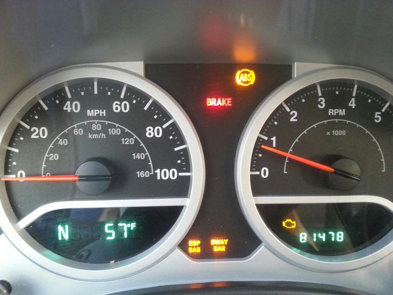

I have the same thing happening in my 2008 Rubi UNL.
Mine is intermittent and I also throw a ABS loss of communication code.
I recently had an ABS issue with my daughters 2001 VW and was able to send it out and have it rebuilt for less than $100. I think I will see if ours are rebuildable. It may be a cheaper option.
