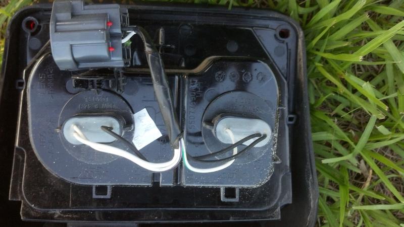

I'm pretty sure the white with green stripe is the reverse light wire too. (right side in picture)
Where did you ground the negative? I grounded mine on the black wire at the tail light. I remember reading about others seeing weird goings on with the tail light circuit.

My Jeep is a 2010 Unlimited Sahara. The picture is the passenger (right) side tail light assembly. The bottom (where the backup light is) is on the right in the picture. As you can see, the wire going to the right is white with a green stripe. The same part number bulb is used for both the tail/brake and for the backup. On the backup both filaments are wired to ground (2 black wires on the right) so they both light giving a brighter reverse light.
I connected my back up camera power (wht/grn) and ground (blk) on the assembly instead of the harness because it's cheaper to replace the assembly than the harness if I screw it up.
I read somewhere that when the lights and brake are off, the ground floats. I'm not sure how that affects the backup light problem you are having but if you used the wires going directly to the bulb it should solve the problem (bulb lit, camera powered).
