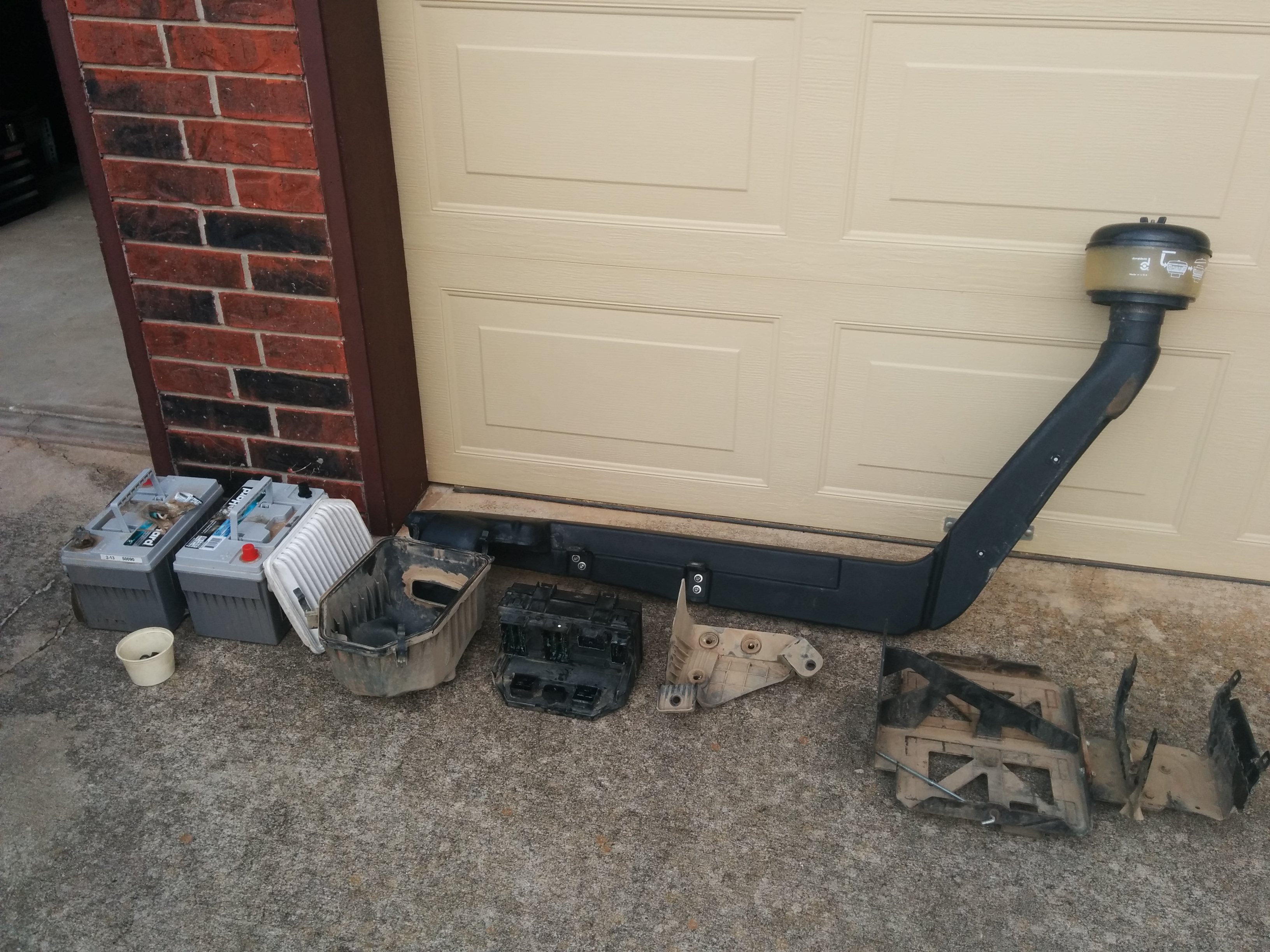

Benchmark Designs is out of business. And it was only available for the 3.8 motors. I do run the Benchmark Designs kit with the OEM alternator. I used to have two Optimas, but didn't get the life out of them that I would have expected. Replaced them with Sears Diehard Platinums (not the Marine versions) and will see how that goes. There is a lot of heat in there and that is very hard on batteries--especially the one adjacent to the engine (which with my setup is the starter battery).
Other thoughts: OEM Spark plugs are good for 100K miles. Recommend change them while installing a dual battery kit so you put off for as long as possible before having to tear into that again--your dual battery will make that a bit more difficult. This is what I had to pull to do mine this last weekend (and, no, access through the fender was not possible because of the larger battery tray):
Name:	Swap Spark Plugs, Aug 15, N5_4844, Parts Removed for Access.jpg
I was replacing NGK plugs that had 75K miles and that had replaced OEM plugs at 95K miles (when I installed the kit). The $4 apiece OEM plugs looked to be in much better shape than the NGKs.
Finally, Mean Green and Premier Power Welder sell upgraded alternators, if you're concerned about needing more current. I'm still using the stock alternator, but my primary draw on the aux battery is pretty low current stuff. Yes, there's lots of high current stuff connected up to it, but I don't spend much time running the winch, aux lights, etc. It's more running a couple video cameras, a 7" tablet, inverter powering camera batteries, fridge, etc. When stopped, aux battery powers the fridge and for an hour or so each day, a laptop (while I transfer videos and photos over to its hard drive). Aux lighting is used only very occasionally--when late getting to camp, when setting up camp, etc. I don't usually plan to drive at night, but rarely it just happens (it's more risky, there's no scenery to enjoy, and the video always sucks).
