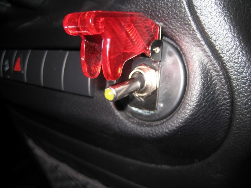

Originally Posted by mhockey9090
Did you mount the switch somewhere inside the vehicle or did you hook up to an SPOD ?
I did run it in the vehicle and not off the sPod. The sPod uses unswitched power and I was uncomfortable with that so I ran switched power. Meaning the key has to be on for the switch to work. (I have a soft top)
Originally Posted by Vladimer
Any ideas what the solenoid is rated for? I was looking into it last year but couldn't find anything definitive on it, even on warns site.
No. I couldn't find much on it either. Figured it was Warn and would therefore be sufficient. Don't really know for sure but it hasn't failed on me. But I have only had to use it twice.

Old Mar 10, 2015 | 02:47 PM
DJ1's Avatar
DJ1
Former Member
Posts: 2,573
From: USA
Originally Posted by 14Sport
Hahaha...that's why I did mine. Used the Warn power interrupt kit.
haha that's currently why I have mine disconnected under a locked hood....planning to buy those beefy connectors
Old Mar 10, 2015 | 02:56 PM
DJ1's Avatar
DJ1
Former Member
Posts: 2,573
From: USA
I've been wanting to run a switch like that for something. Now I might be able to
Old Mar 10, 2015 | 02:58 PM
14Sport's Avatar
Joined: Nov 2013
Posts: 3,703
Likes: 8
From: The Dirty South
I have to admit...they are cool. That's fighter pilot sh*t right there.
