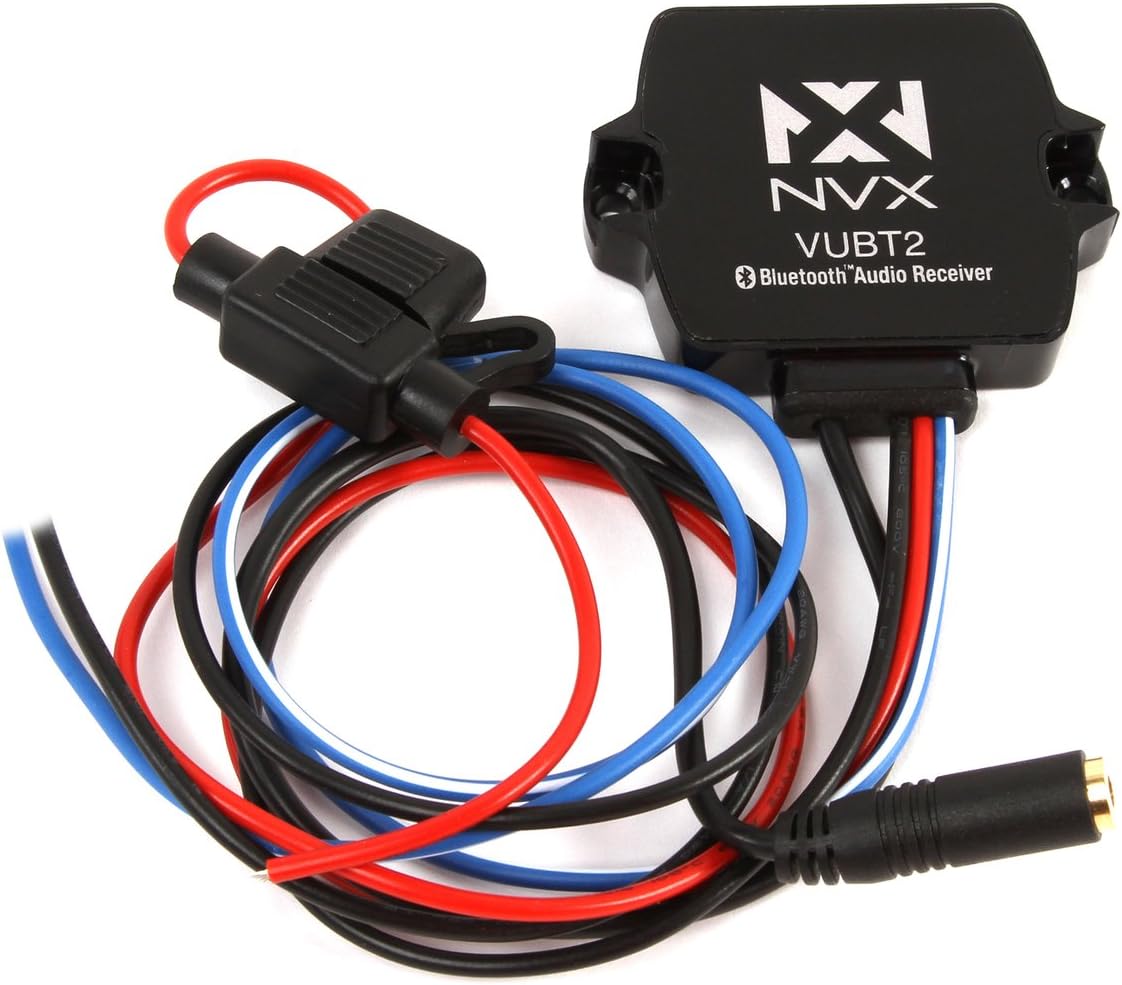

Ahhh, here's something that looks to be what I'm looking for!
I wonder what it would take to wire that into the stereo so that using the Aux input would result in a signal from that receiver... Would be pretty slick if I could get it to work!

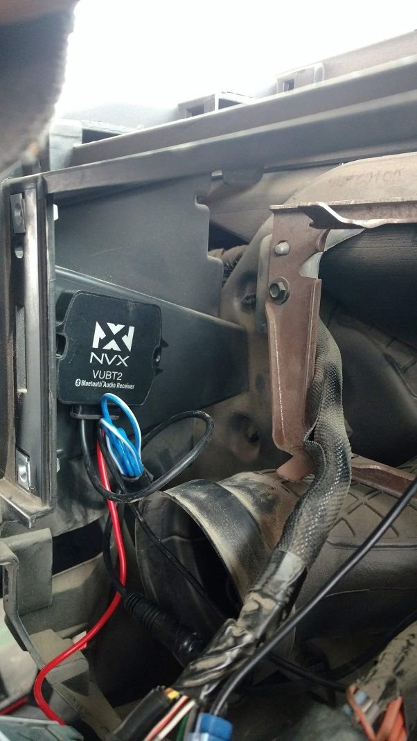

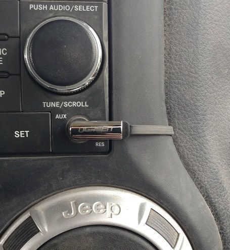

So I got the module installed. Spliced the power and ground into the dash 12v adapter so it'd only have power with the key in, ran the Aux cable out through the pieces of the dash, and mounted the unit itself inside the dash against the driver side so it sits just a couple inches away from my phone mount. Initial reactions are that it's a brilliant success. Pretty cheap, easy to install, seems to work great. Not QUITE as elegant as I would have liked, as I couldn't get it hardwired in, but over all I'm quite pleased so far!
Mounting location. Blue wire doesn't have (as far as I can figure out) any purpose in this application, so it's taped up out of the way.
The totality of external evidence. Got a nice flat 90 degree jack so it doesn't stick out, in chrome/black so it matches the rest of the trim on the stereo.

The blue is usually your amp turn on wire, maybe it's meant to be a part of a boosted mobile system where you can turn on the amp and just plug in your sound.
Old Mar 2, 2020 | 11:04 AM
RedRubycon's Avatar
Joined: Jul 2018
Posts: 186
Likes: 25
From: Aliso Viejo, California
Correct, but since in this particular instance the audio output is from the receiver to the stereo via a standard 3.5mm audio jack it means everything that's being sent to the sound system is being handled by the stereo.
Thus, as far as I can tell, no need for that blue wire on the Bluetooth unit!
