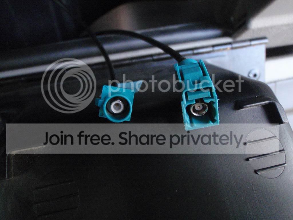

XM/Sirius radios have used the same antenna since they both started, the satellites use the same frequency range, and they've used the same connector for the past 5-6 years.
But that's for "normal" stick to the windshield type receivers, OEM radio might not use the same connector.
If it looks like the one on the right (the center part, this pic isn't from a chrysler product) then it should work, you could just trim the plastic off. Unless your aftermarket deck has it's own connector to force you to buy their antenna. But someone probably makes an adapter from chrysler->pioneer/kenwood/jvc/sony etc
