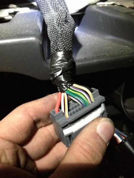

Hey guys,
Recently put some new floods on my 08' JK, and they look great! Unfortunately, the copper clips that held the trim piece on fell inside the female end inside the radio so I pulled it out to get them.
When I pulled the radio I noticed that I had 8 wires for the speakers, a positive and a negative, a memory wire, and one more. This was the only plug in the radio, and when I removed it no functionality changed from what I could tell (dimmer, noise, etc).
Do I have canbus?

Yes you do the can high and low are the two white wires close to the main power red wire

RADIO - GRAY (INSTRUMENT PANEL) 22 WAY
Mopar Package #: 68032281AA

[/TABLE]
