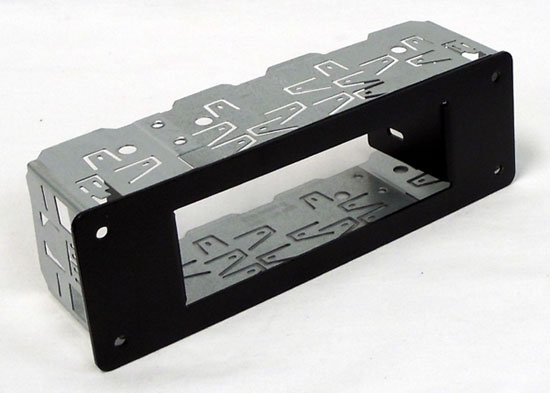

Use bracket DIN0020
For use with these radios:
  • Uniden PRO510XL
  • Uniden PRO520XL

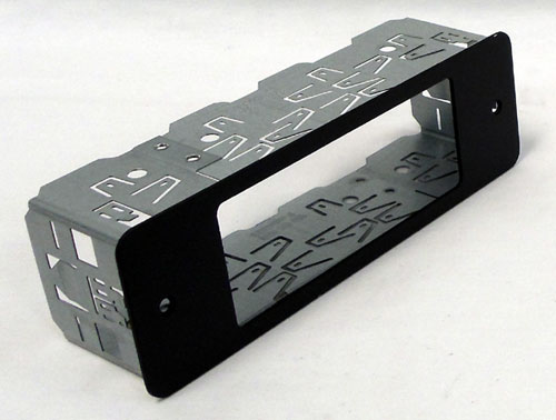

OR use this bracket DIN0240
  • Cobra 19DXIII
  • Cobra 19DXIV
  • Midland 1001Z
  • Midland 1001LWX
  • Maxon MCB40
