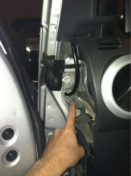

Pop off the plastic piece on the side of the instrument cluster. Behind this you will find the hole in which to run the wire. Again, this is drivers side. I did have a little trouble bringing the wire through secondary to the diameter of the wire. Just be patient and be careful not to cut the wire on the metal while pulling it through.

Awesome that is the perfect spot. Thank you Jktough and everyone else who gave their input.
