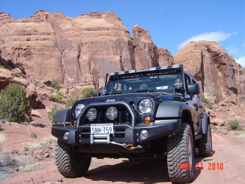

I have one and i agree with everything said above.

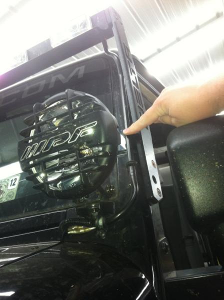

Light output is ok for regular bulbs and wiring was not well planned. They want u to run the wires from back of bar on passenger side through the top corner of door gasket. Hell no! These tops leak enough without extra crap touching the In the door gasket. I made a down tube for mine that attached from bottom of horizontal light bar along driver a-pillar down to the pillar mounted lights and ran my wires inside to tube. When i got done with it my friends tell me they thought it came that way. Looks clean

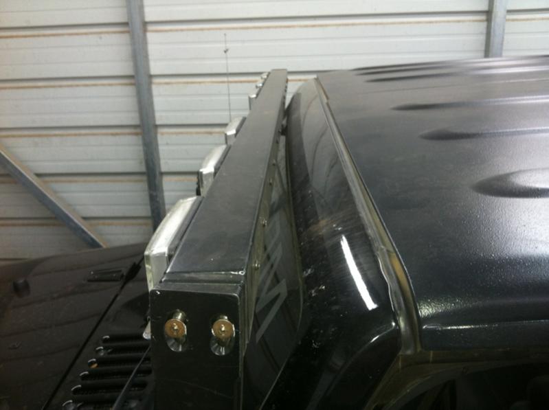

The top of lightbar is flush with top of jeep

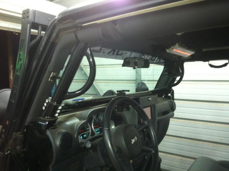

From inside the jeep u cannot see any of the lightbar arms or the bar itself. Driving with it installed feels like it is not even there, except for additional wind noise since any lightbar disrupts the airflow over the windshield and roofline.

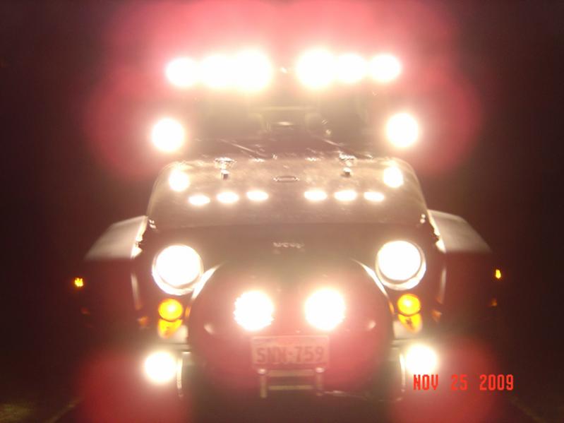

When i was in Moab, my friend and i went for a tour at around 2am with all the lights on. We were slowly coming up and over a hillside and as we came over the top there were jeeps everywhere. We pulled up beside one guy pouring out his beer and i introduce my friend and i and this guy said to me " i poured out my beer when i thought the sun was rising at this time of night. I knew right then i have had too much to drink!". Several other guys laughed and agreed, my jeeps lights gave a glow on thier side like the sun was coming up and since these new jk's are golf cart quiet, they didnt hear us at all until on thier side of the hill. Quite funny to me.
