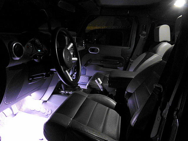

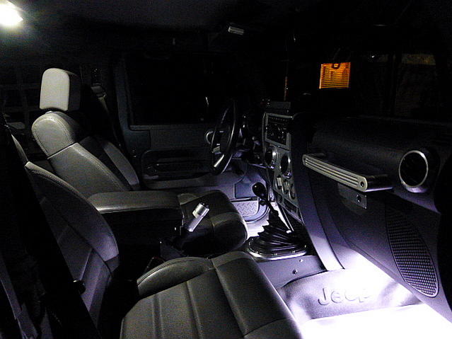

I use the Northridge LED dome bulb, and tapped into the dome light an additional super bright white 12" led strip along soundbar, and 12" strips in each footwell for a lot of use able light

Old Dec 28, 2012 | 11:22 PM
headrock's Avatar
Posts: 162
From: Virginia
Where did you tap power for the ones in the footwell? Nice set-up btw

Thanks everyone. So northridge seems to be the place to go. I will be calling them monday. Yeah that footwell looks awsome with those bright lights. And the question was brought up, where did you draw the power?
thanks I just ran wire up the A pillars, through cage padding, into the soundbar plastic. Using the ends of the dash, A pillars, and roll cage, I was able to hide every bit of wire and connections. Nothing visible even if you're looking for it. Removed dome light, drilled two small holes in soundbar plastic for the two new wires to come in, and tapped into the power wire for the dome light. Stuffed it all back up under the dome light. A couple T-taps and 5ft of wire per side, good to go. Hooked the grounds for lights to the OE grounds at the end of the door straps in foot wells. Took only 45min or so for a ton of extra light.
