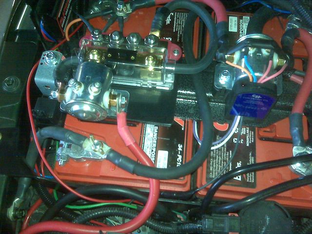

I wouldn't hesitate to purchase and install another Benchmark setup, regardless of the posts I've read. I am extremely happy with the quality of mine, and in the end, that is what your paying for. I realize getting it fast is nice, but I consider some things well worth the wait. This is one of them.

I see some terminals and connectors on those batteries. What are those?

I bought the Rugged Ridge tray and a Cole Hersee Solenoid (I think that is the same solenoid Benchmark uses) and I don't see how mine would be any less in quality than Benchmark's. I have not personally seen Benchmark"s setup, but IMO a tray is a tray as long as it fits properly and is made well. The solenoid is the key. Granted he gives you all the cables but anyone can get that done for them cheaply. Just my thoughts, anyway.

About the only thing I did differently on mine was utilize a custom bracket from a fellow forum member, rather than mount the tray support underneath by the shock. Which also provided a mounting bracket fot the cannister.

LOL I have the Smart isolator from Cole Hersee, then I'm running to a 200 amp knife fuse, which in turn runs to a solonoid for my winch, so I can keep it dissabled until a switch is thrown in the cab. There is also a power distribution bar so I can run more power out lines from my aux battery without going directly to my battery post.( HID driving lights, HID 170 offroad lights)
The power for my trans cooler fan is coming off of my main battery, so it only can be turned on when the ignition is on.
They are running in series, with the option to "boost" via the Cole Hersee smart isolator.

Yes it may indeed be overkill, but it does give me peace of mind to have an OFF switch, and some overload protection. It also allowed me to install another switch on my dash! lol
