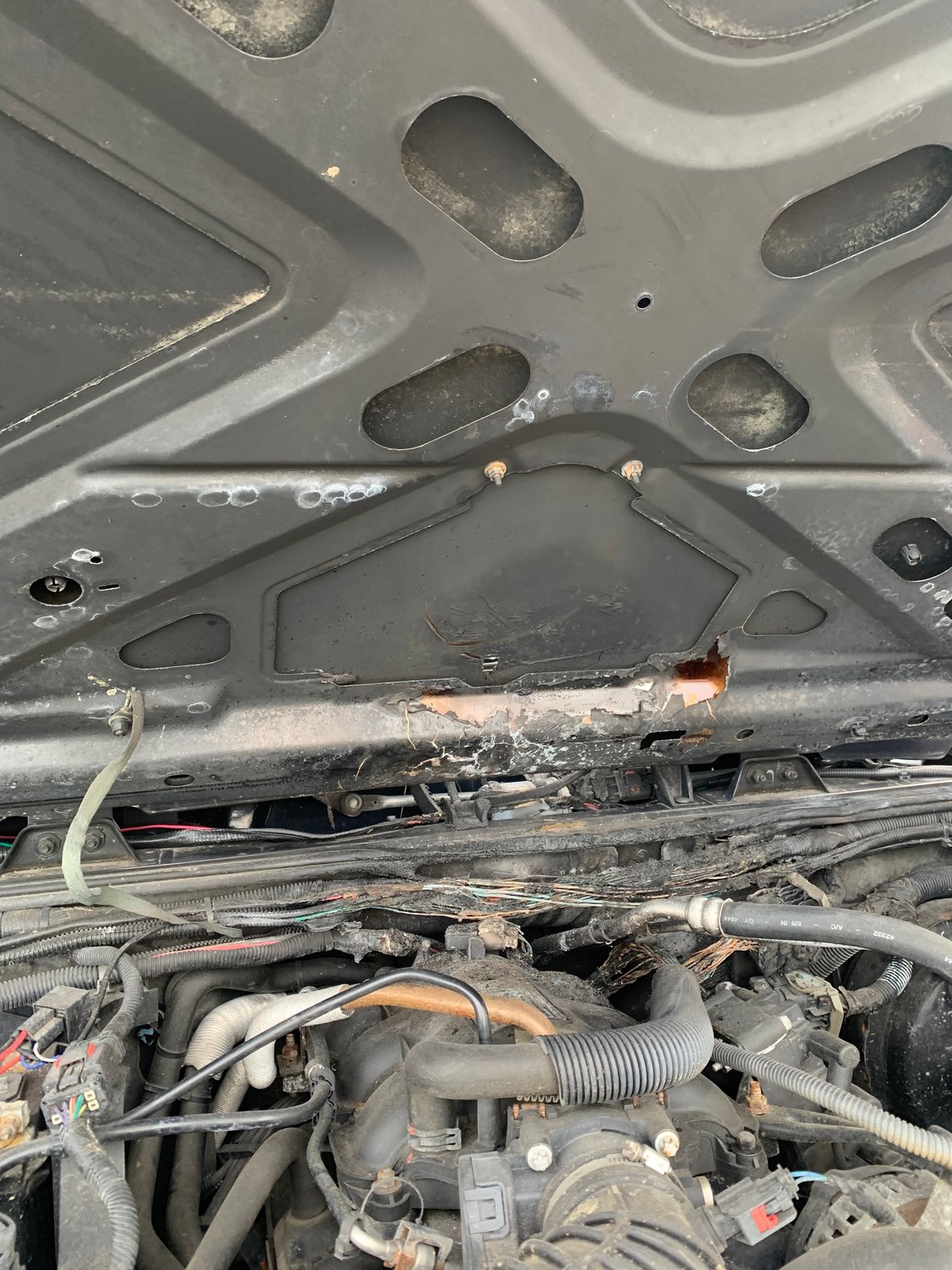

I知 just wondering if anyone has any experience with replacing the main wiringharness in a 2009 jk? I have searched online and haven稚 found much info on this project.
I found a jeep 2009 jk 2-door manual transmission, with salvage title, that had a fire right on top of the engine, but only burned up the main wiring harness and melted the intake cover.
Looks like a simple fix, but I知 just wondering if there could be other issues that I知 overlooking. Would the computer system be damaged from the fire (I知 not sure where the computer is located), will it be throwing codes constantly once fixed?
I致e also read these fires are somewhat common in these year models. Does anyone know what the cause could be, could this thing catch on fire again after i fix it?
Thank you for any advice and recommendations you might have.

Hopefully you got it cheap enough as there are some major harnesses there that are burnt. The main ones are best purchased as new ones c/w plugs. That main plug above the brake booster looks damaged on both sides so not sure if even using a new harness from the TIPM will be good enough. Be prepared to fork out at least $600 for harnesses. Doubt if the ECU is damaged as it uses 5V signals. If wires shorted the fuse is most likely gone. Burnt cars are really difficult to completely fix.
