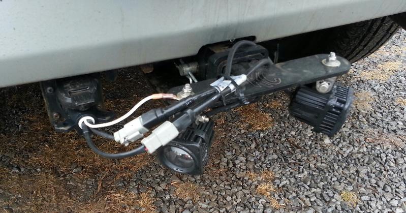

I used a 7pin plug and wired them to the reverse pin and the ground pin. Initially they would only work with the running/head lights off. When I grounded them to the hitch they work with the lights on and off (never towed much or I would have known to ground them to the hitch by default). Further more why is a ground even in the plug if its not sufficient to run the lights or anything else.

Here's the pic.
