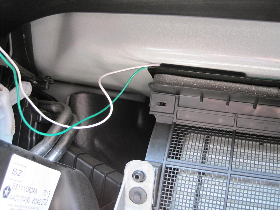

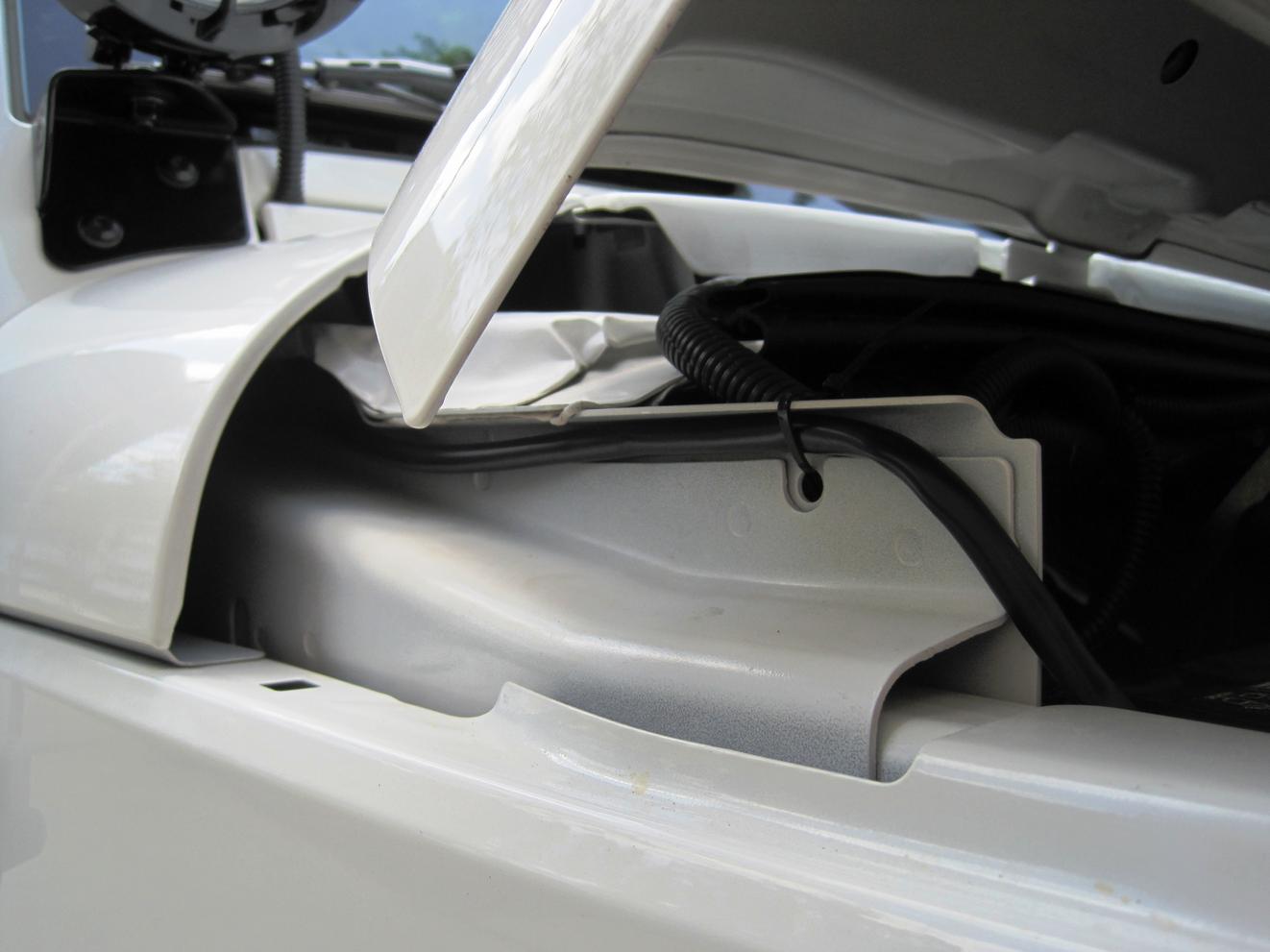

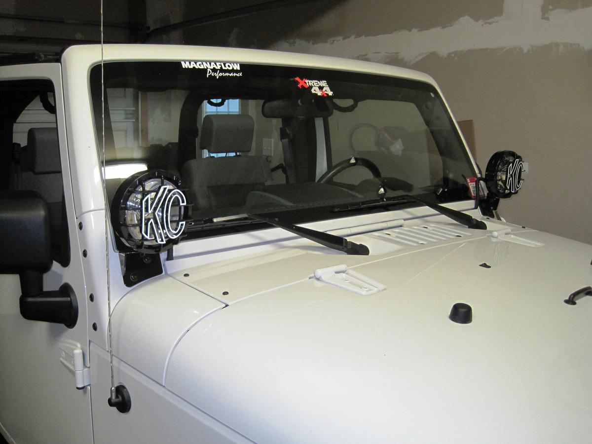

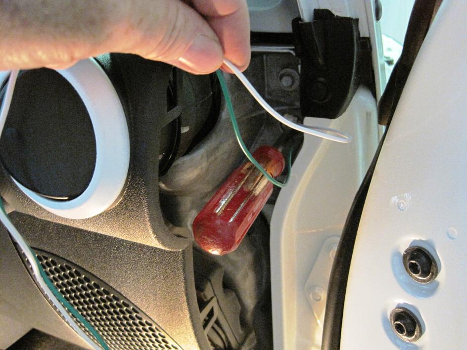

If the 4dr is similar to the 2dr there is no need to go thru the firewall to wire lights, I ran a set of windshield mount KC on my '09 - see pic's - if you need more info send me a 'pvt message' and I will respond.
