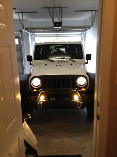

I also ran into this problem. So i went to advance auto parts and picked up some fog lights and mounted them on the bumper. There actually really bright also

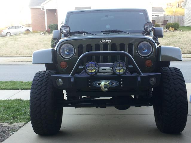

Why not just run some desperate wires and do this?
